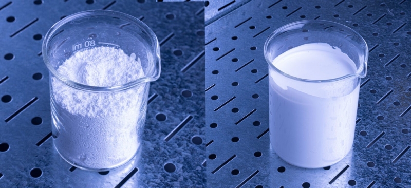

Here's a brand new article by Victor Espeland, the Communications Manager for Dr. Beasley's. Victor is a talented writer and I highly recommend reading the article below.
Composite Microspheres: The tech behind Z1’s shine
