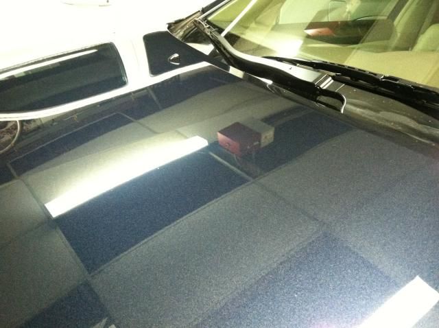

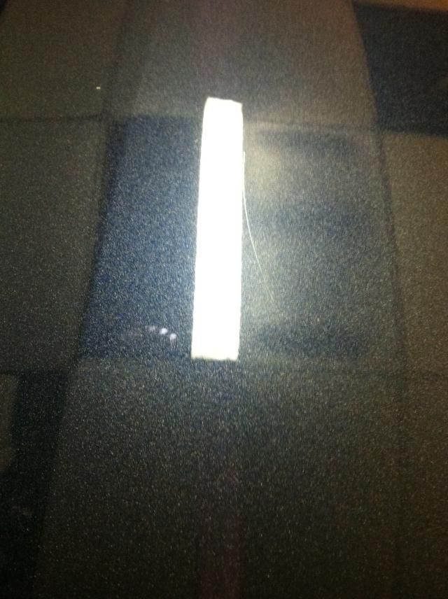

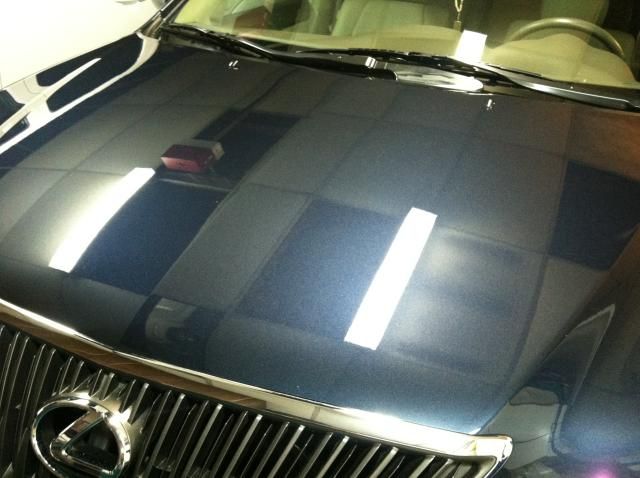

Alright. No luck with the before and after pics.
The customer was supportive and I got confused off the bat with what he wanted. I ended up doing a wash, Clay, D151 , and CAR PRO reload on top.
Wheels were cleaned with iron x and Meg's wheel and tire cleaner. (Ran out of my gallon of Sonax).
I polished the windows with..... A little trick I picked up.....Meg's m105. Works great on glass with a microfiber pad
Exhaust tips were cleaned with p21s polishing soap and some very fine steel wool.
Everything looked great. I'm still frustrated about the back window.
