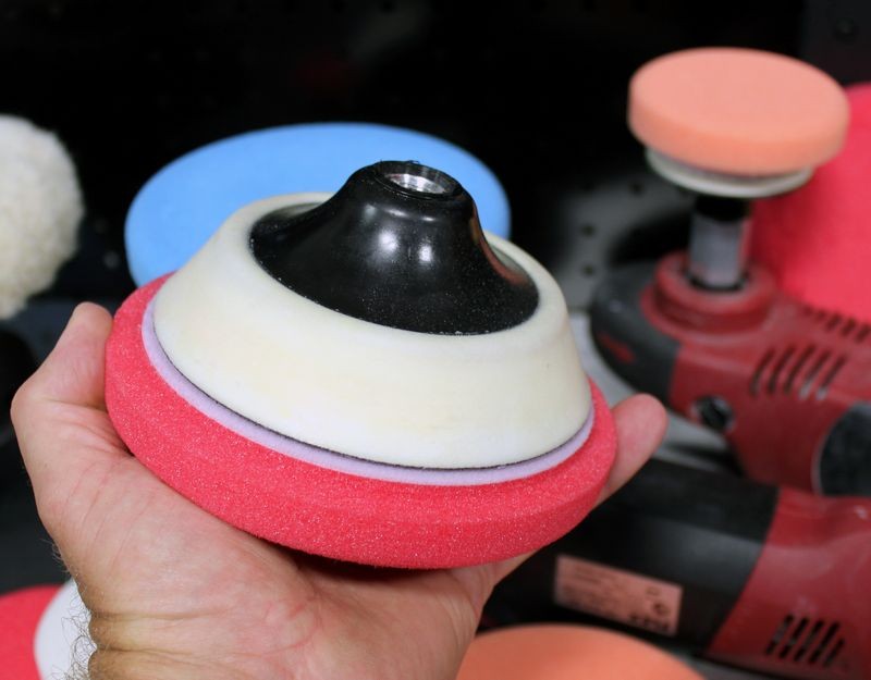

    Well two days after I got my new Flex 3401 I did this...
    I used a 6.5 wool type pad made by Technicians Choice. I did an entire vehicle with the one pad fluffing it a few times with a spur. I noticed the head was quite warm while I was doing it but didn't think much of it at the time.
    About an hour after finishing the job I went to take the pad off and realized it had melted right to the backing plate of the Flex (#*$*! is some of the dialogue at the time). Anyhow I tried for 20 minutes trying to get it off without damage but I did end up frigging it up a bit as you can see from the attached file. I think it will still work as I will try this morning with a different pad (just regular orange Lake Country). Gah frig.

    Yeah, probably a whole vehicle with one pad wasn't the best thing. Fortunately you can get the OEM backing plate or the Lake Country interchangeable one.
    Flex XC 3401 VRG 5.5 inch Backing Plate
    FLEX XC3401 Mini 4 3/8 Backing Plate, FLEX
    FLEX XC3401 Changeable Backing Plate System

    Usually foam pads are easier to build up heat in, especially if they get saturated with compound/polish, wool generally has better thermal conductivity, etc. Heat can come from 3 places, from the machine itself, from "agitation" at the Velcro interface, or from the paint/pad interface.
    Not a bad idea to switch pads in the middle of the job or at least let it rest for a while, and once in a while feel things to make sure nothing is getting too hot.

    My guess it was the heat buildup between velcro and pad. The backing material of the wool Tec Choice pad is unlike any Lake Country (or other) pad I've seen. I think there was unnecessary movement that caused extra heat build up there.

    I suspect the issue is using a pad designed for a rotary polisher on a DA
    The hood and loop are not compatible on many of these as they are designed for the specific directional stress caused be each of these machines

    I think it's more simple to think of it this way--a dual-action polisher puts more stress on the Velcro than a rotary--so you need more robust Velcro and attachments for DA use. I don't think there are "specific" velcros for rotary vs. DA, it's just you can get away with a less robust (i.e., cheaper) Velcro implementation in a rotary application.

    There are definitely different "specific" hook & loop types that have been developed to work with specific types of pads and papers. They vary in length, shape of the hook, etc.
