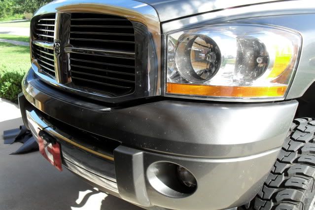

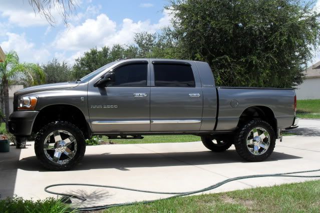

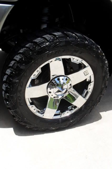

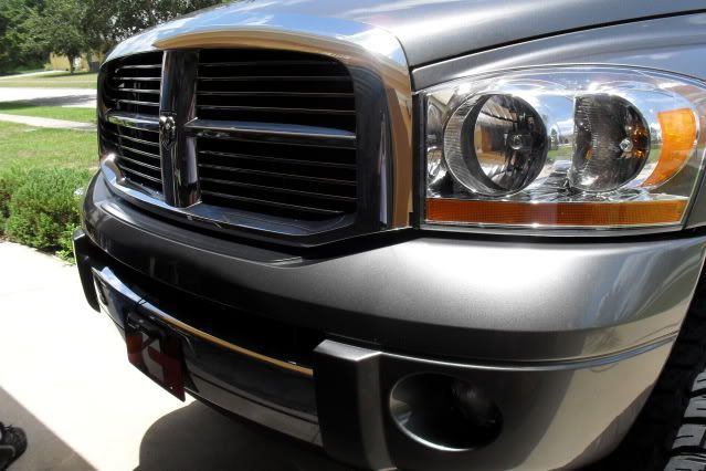

    I recently detailed a 2002 Dodge Intrepid that had heavily corroded chrome wheels.
    Products Used:
    Optimum Power Clean
    Dp Rinseless Wash and Gloss (clay lube)
    Wolfgang Poly Clay
    Eagle never Dull Polish
    Poorboy's Wheel Sealant
    Before and After
    Critical Details
    Trevor Spedden

    "Did u use the never dull to clean out all the grim and all the other stuff? " The lighter stuff like water spots was removed using OPC and Never Dull. While the detailing clay removed the heavier corrosion shown in bottom right of picture three.
