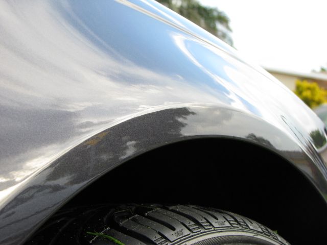

Match your services to your customer
http://www.autogeekonline.net/galler...ail_Biz_01.jpg
First... match your services to your client or market
