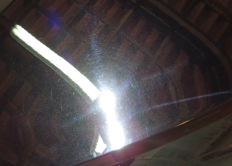

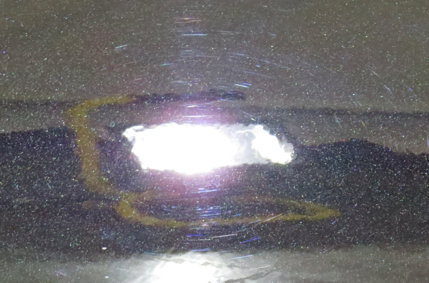

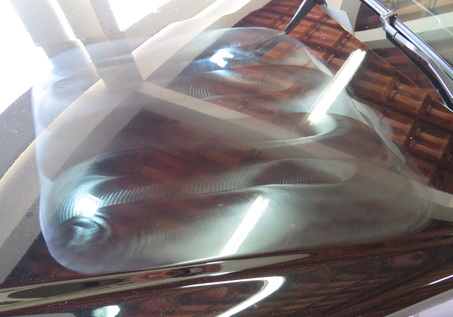

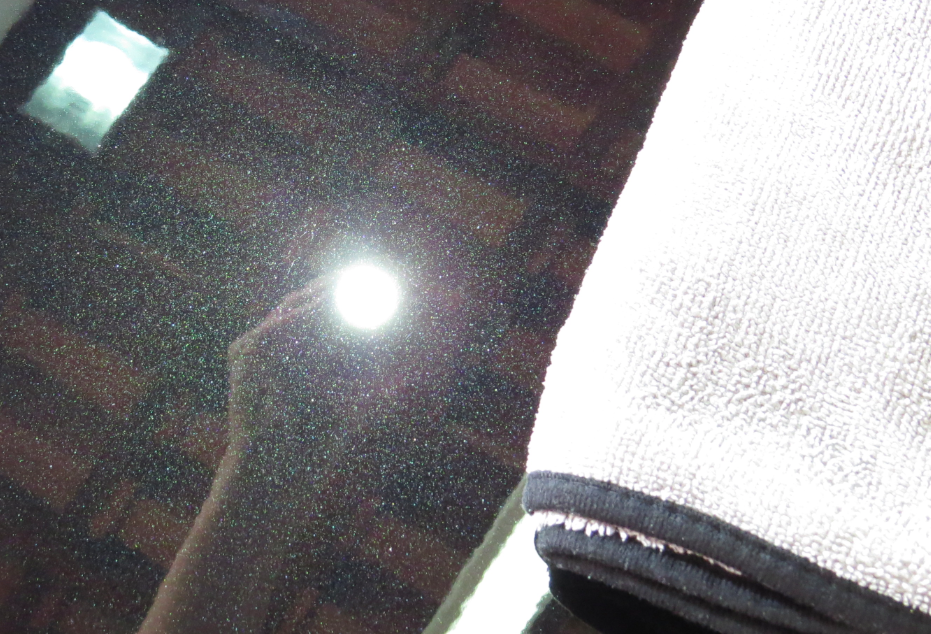

I have all of the products you listed and they are all solid but:
The results I got on this Porsche with FG400 in a one step correction was amazing. It was a swirled mess and had heavy water spots too.
I did numerous test spots with different products and pads and settled in on FG400.
Here's the link:
https://www.autogeekonline.net/forum...orsche+cayenne
