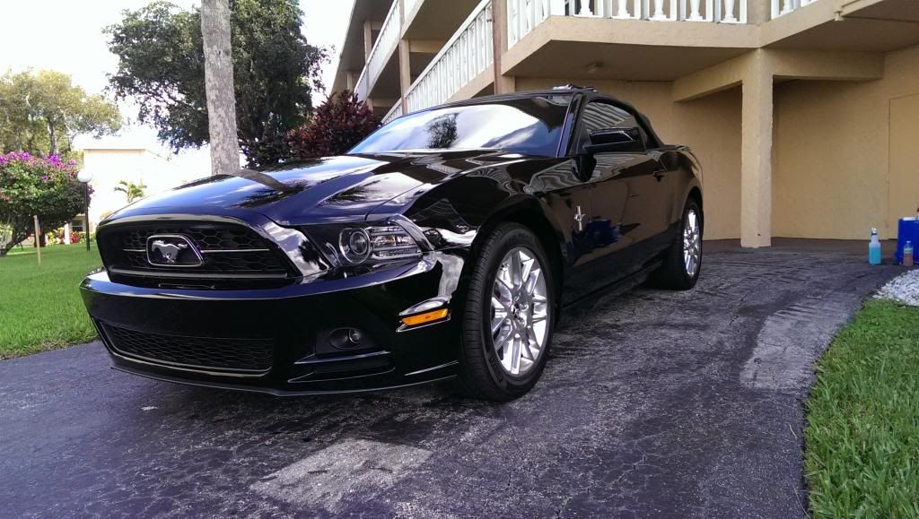

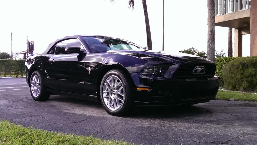

I got my car Sept 10th, 2011 and is was driven, by the salesman, 451 miles to the delaership I bought it from. At the time I had Zaino Z-5 pro and VFX and applied 3 coats the next day after a good wash and clay. I feel there is no need to wait, just check the paint and do what you've gotta do and get with it!

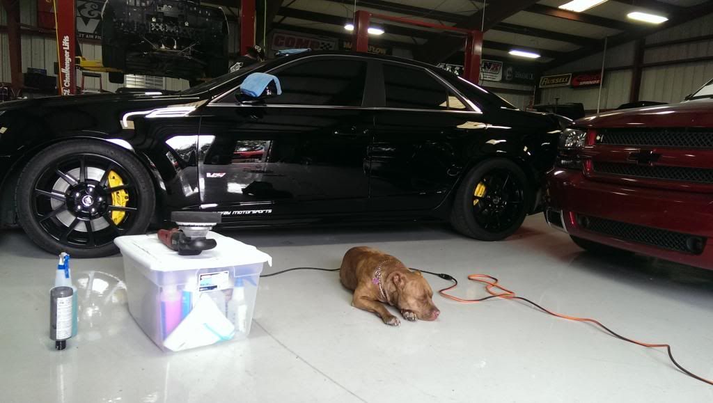

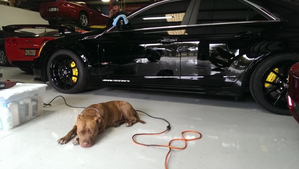

Why did you use the medium grade Nanoskin Autosrub on a new car? I've always heard to use fine grade on anything other than a highly contaminated older car as the medium has a decent chance of maring. Which on an older car will need to be compounded and polished anyway doing away withany marring.
Thanks for this post. I've seen too often the outdated idea that you have to wait a month after buying a new car to coat/seal.
Re: How long to wait before waxing a brand new car?
Quote:
Originally Posted by
ClayR
Why did you use the medium grade Nanoskin Autoscrub on a new car?
Wanted to make sure 100% I removed EVERYTHING off the surface the first pass around while also doing the procedure as fast as I could.
I machine scrubbed the entire car as I found above surface contaminants on the horizontal panels as well as the vertical panels.
I then machine polished all the panels. The use the paint prep polish and then hand applied the coating. All in all from start to finish it took me 6 hours including doing the wheels, tires and glass which I didn't include in the write-up nor took pictures of either.
ClayR
I've always heard to use fine grade on anything other than a highly contaminated older car as the medium has a decent chance of marring. Which on an older car will need to be compounded and polished anyway doing away with any marring.
Amazing thing... after using the Medium Grade over the car both the owner and I inspected using both the Brinkmann Swirl Finder Light, (fully charged), and the Rupes Swirl Finder Pen Light, and neither of us could see any marring anywhere.
I'm going to credit this to the Ceramiclear finish. I've posted this multiple times on this forum but here it goes again...
I'm a HUGE fan of Ceramiclear paints.
ClayR
Urban legends die hard...
custmsprty
Congrats on the new ride, it's awesome.
That second picture makes me so thankful I live in Florida. :wow:
Back atcha...I've been partial to black cars, and I love your Genesis! Yes, road salt is a part of daily life up here in the winter!
