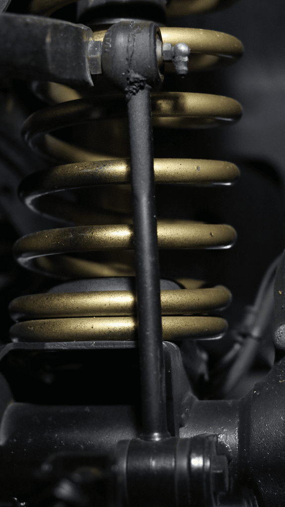

    As part of my "How Particular Are You" thread, I wanted to share this bit of advice dealing with removing over spray from powder coated products. Last winter in an attempt to clean the jeep's frame, But I didn't correctly protect the gold coil springs before I used a can of black spray paint. For one I've learn my lesson about using spray cans without properly masking or covering products I don't want sprayed. Instead and next time, I'll be using an oil based paint and several foam brushes while laying on the garage floor detailing the frame of the jeep.
    But as the title says, I wasn't as careful as I should have been when protecting products or parts under the jeep. The gold coil springs just happen to end up with a small amount of over spray on them. Thus I set out to locate a product that would not harm the powder coating yet remove the over spray easily. According to our powder coater, the coil springs have 3 coats of the gold color and 2 coats of the clear, but he didn't say what was the best way to remove over spray or just clean the parts afterward.
    Testing products like Goo Gone, Simple Green even using a clay bar at one point etc I ended up using Goof Off with a well used dish washing pad. Please note that if you're going to attempt do this on your powder coated products, make sure that the dish washing pad is NOT the scotch-brite brand as these pads are very abrasive. The before image shows that I wasn't so particular on that day while under the jeep attempting to touch up a few small rusted areas.
    Last weekend, I put the Goof Off to the test while my nephew added and adjusted a several new plated parts for the jeep. In doing so He removed the front wheels which allowed me to access the front coil springs. This process took approx 15 mins per-side and never harmed the powder coating. I was almost ready to take photos of this, but the camera's battery died due to the cold temperatures.
    So this weekend being near 60 degrees, I'll give the jeep a good wash, take those photos and report back afterward.

    Realizing my eyes are going bad, I did happen to miss a few small areas of over spray on the back side of the coil springs as indicated by the latest picture. Plus, one might notice that I have a small nic on the front facing coil. I'll locate some color matching nail polish later this week.
    How to Clean/Remove Over Spray From Powder Coated Products-imageedit_3_2429551257-jpg
    But as compared to the above image, I've made some noticeable progress with the Goof Off and an old dish washing pad. With weather turning colder and not having a shop to spend more time on this, I'll have to wait till next spring to reattempt cleaning the springs.
